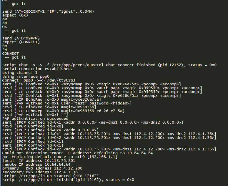

linux-ppp-scripts_V1.2.zip (4.18 KB, 下载次数: 23752)
附上拨号脚本

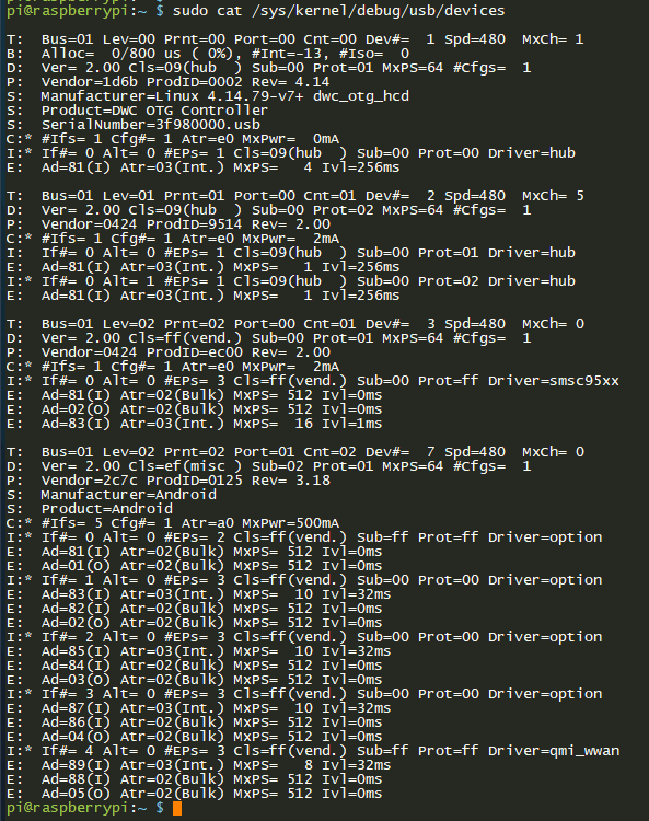

Mcuzone_Robin 发表于 2019-5-17 10:47:35
首先看一下树莓派3B的系统信息:
pi@raspberrypi:/etc/ppp $ cat /etc/issue
Raspbian GNU/Linux 9 \n \l
pi@raspberrypi:/etc/ppp $ cat /proc/version
Linux version 4.14.79-v7+ (dc4@dc4-XPS13-9333) (gcc version 4.9.3 (crosstool-NG crosstool-ng-1.22.0-88-g8460611)) #1159 SMP Sun Nov 4 17:50:20 GMT 2018
