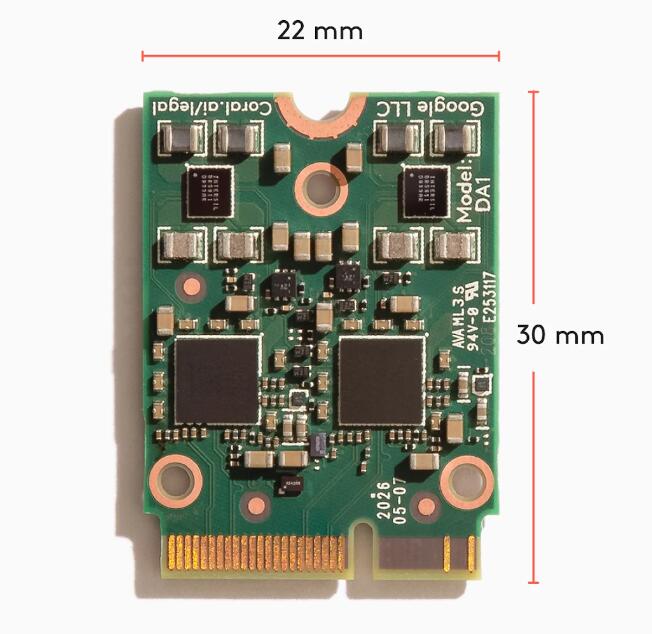

PRODUCT DETAILS
The Coral M.2 Accelerator with Dual Edge TPU is an M.2 module that brings two Edge TPU coprocessors to existing systems and products with an available M.2 E-key slot.
Features
Performs high-speed ML inferencing: Each Edge TPU coprocessor is capable of performing 4 trillion operations per second (4 TOPS), using 2 watts of power. For example, it can execute state-of-the-art mobile vision models such as MobileNet v2 at almost 400 FPS, in a power-efficient manner. With the two Edge TPUs in this module, you can double the inferences per second (8 TOPS) in several ways, such as by running two models in parallel or pipelining one model across both Edge TPUs.
Works with Debian Linux and Windows: Integrates with Debian-based Linux or Windows 10 systems with a compatible card module slot.
Supports TensorFlow Lite: No need to build models from the ground up. TensorFlow Lite models can be compiled to run on the Edge TPU.
Supports AutoML Vision Edge: Easily build and deploy fast, high-accuracy custom image classification models to your device with AutoML Vision Edge.
Description
The Coral M.2 Accelerator with Dual Edge TPU is an M.2 module (E-key) that includes two Edge TPU ML accelerators, each with their own PCIe Gen2 x1 interface.
The Edge TPU is a small ASIC designed by Google that accelerates TensorFlow Lite models in a power efficient manner: each one is capable of performing 4 trillion operations per second (4 TOPS), using 2 watts of power—that's 2 TOPS per watt. For example, one Edge TPU can execute state-of-the-art mobile vision models such as MobileNet v2 at almost 400 frames per second. This on-device ML processing reduces latency, increases data privacy, and removes the need for a constant internet connection.

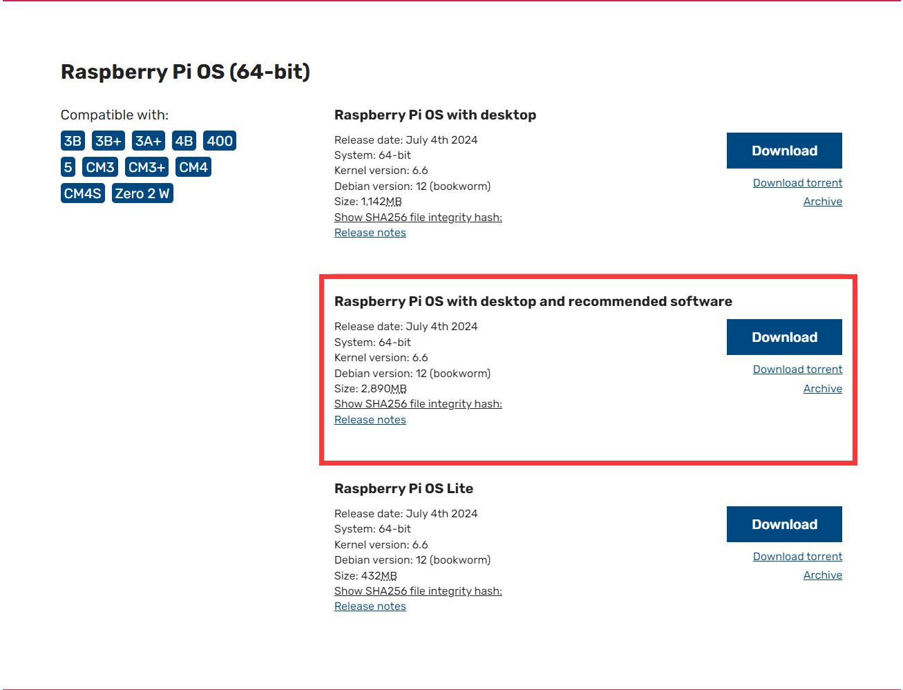

在驱动安装之前首先在官网下载最新操作系统版本
系统烧写完成后插入树莓派5并安装好MPDTPU扩展板后启动进行驱动安装

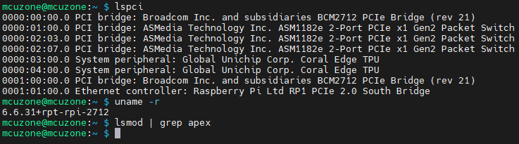

系统启动后打开命令行终端输入
uname -r
确保内核版本大于4.18后输入
lsmod | grep apex
确保没有输出则可以开始安装TPU驱动

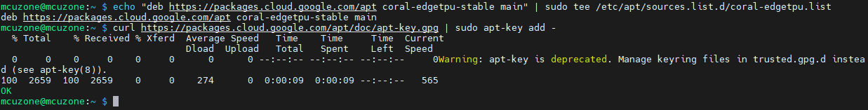

首先添加Google TPU软件库
echo "deb https://packages.cloud.google.com/apt coral-edgetpu-stable main" | sudo tee /etc/apt/sources.list.d/coral-edgetpu.list
curl https://packages.cloud.google.com/apt/doc/apt-key.gpg | sudo apt-key add -

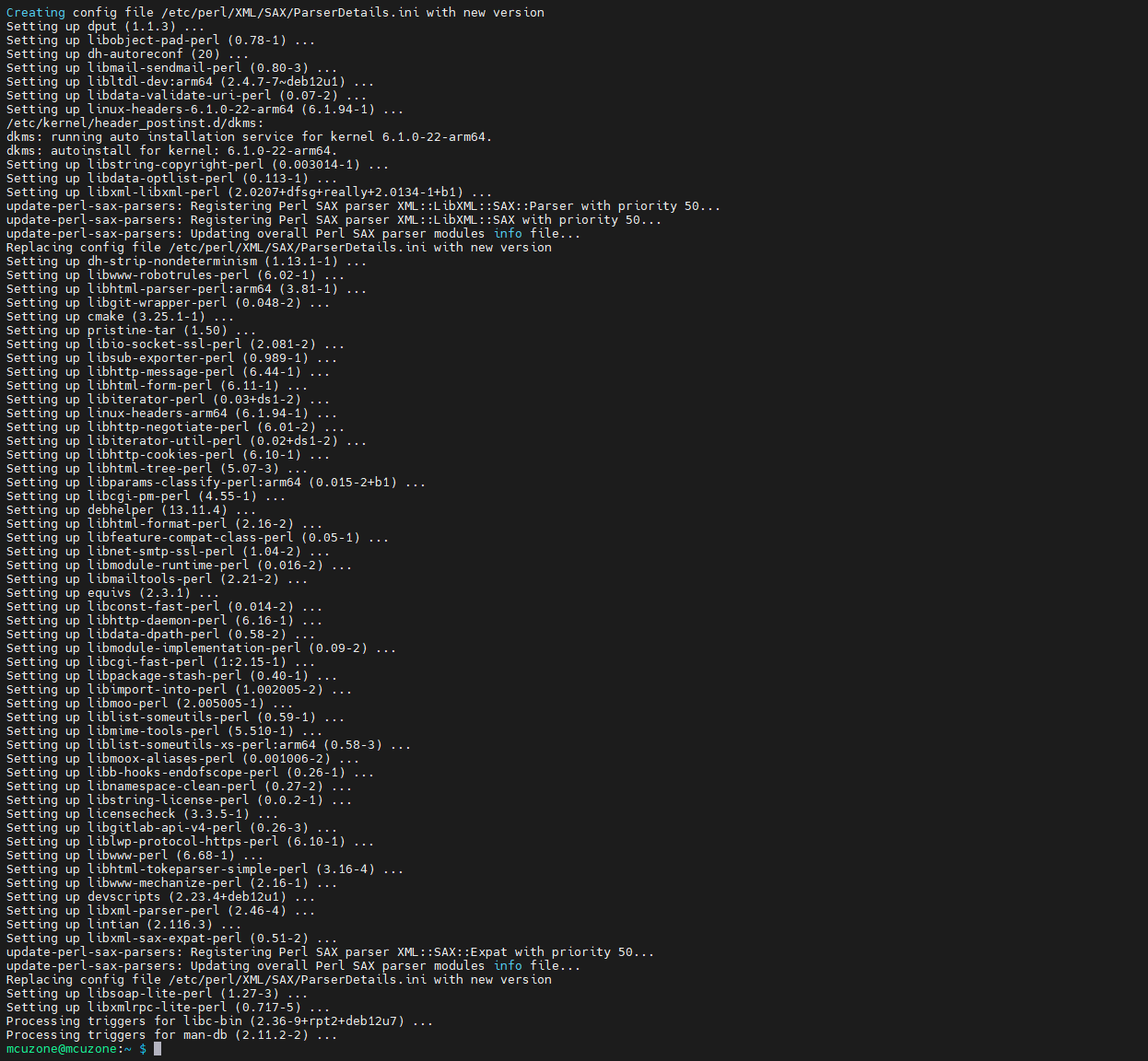

更新完成后安装必要的软件
sudo apt-get install cmake libedgetpu1-std devscripts debhelper dkms dh-dkms

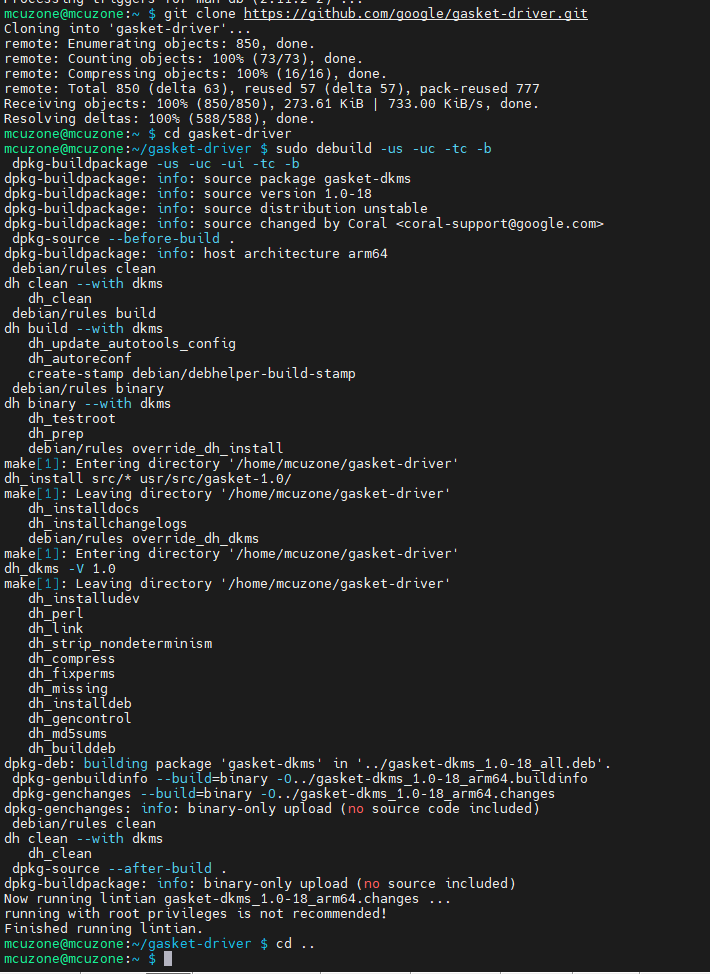

等待安装完成后依次输入以下命令安装Gasket Driver
git clone https://github.com/google/gasket-driver.git
cd gasket-driver
sudo debuild -us -uc -tc -b
cd ..

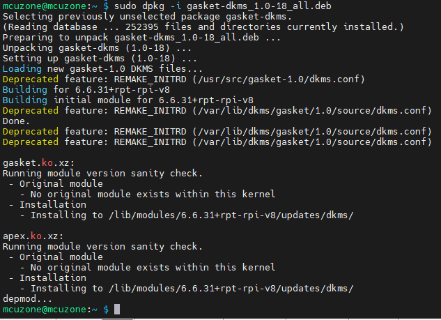

sudo dpkg -i gasket-dkms_1.0-18_all.deb

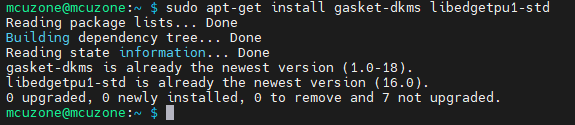

安装完成后输入命令确保驱动以及软件安装成功
sudo apt-get install gasket-dkms libedgetpu1-std

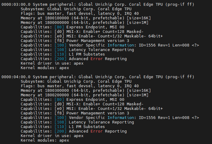

系统启动后验证模块检测以及驱动安装
lspci -nn | grep 089a
ls /dev/apex_0
输入sudo lspci -v可以看到驱动加载

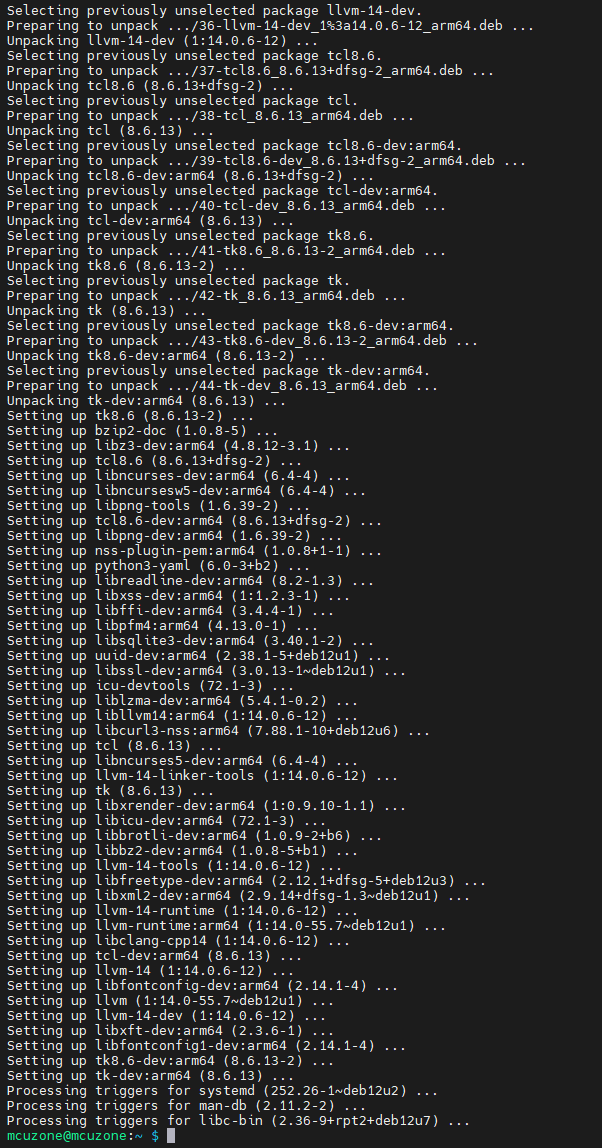

首先进行依赖安装
sudo apt-get install -y make build-essential libssl-dev zlib1g-dev \
libbz2-dev libreadline-dev libsqlite3-dev wget curl llvm libncurses5-dev \
libncursesw5-dev xz-utils tk-dev libffi-dev liblzma-dev python3-openssl

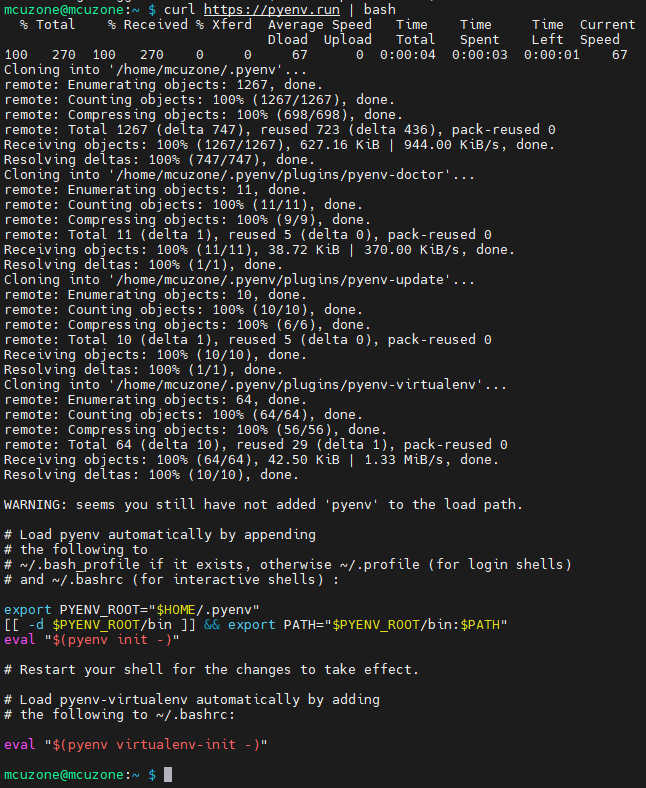

curl https://pyenv.run | bash

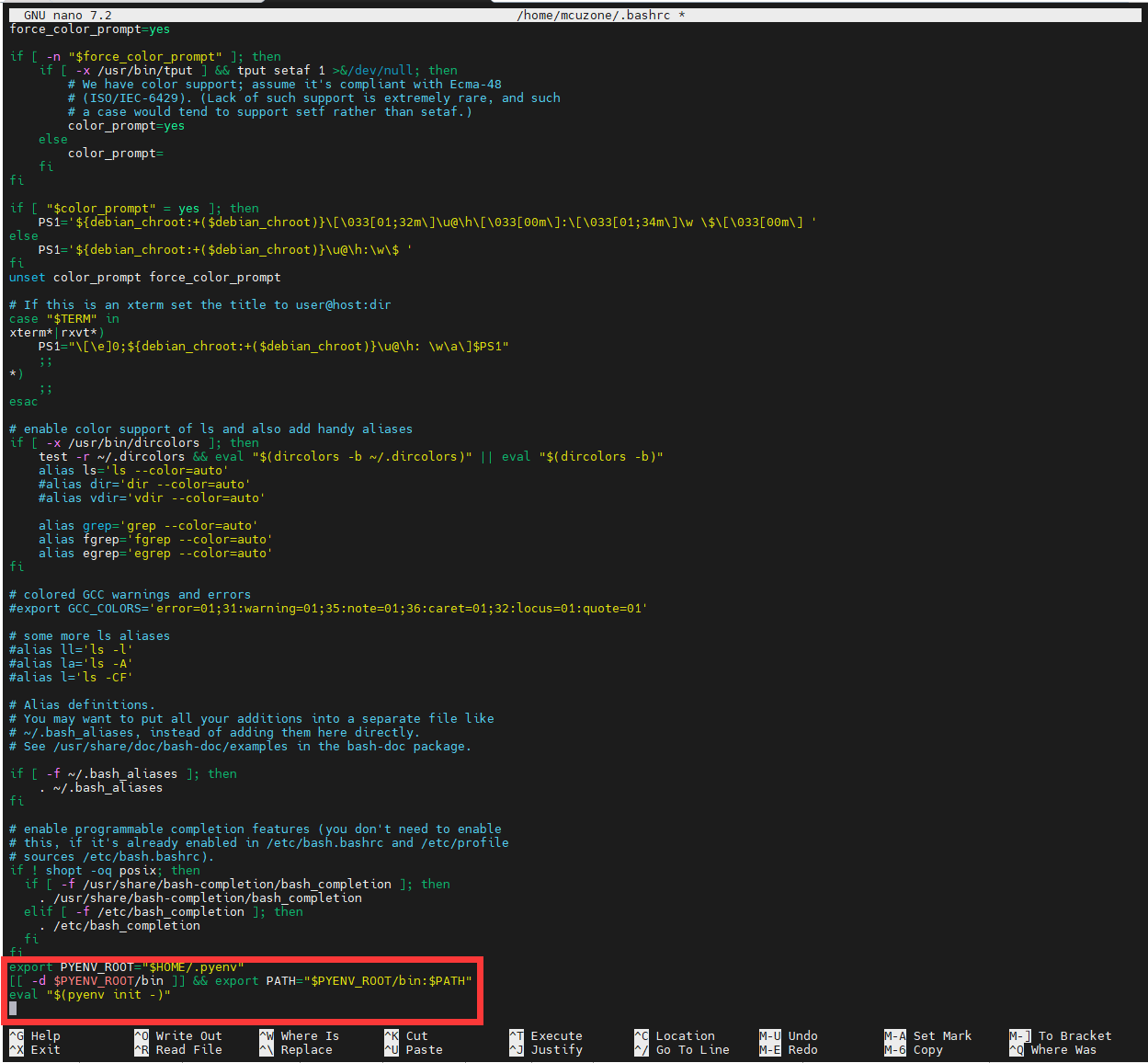

按照提示输入sudo nano ~/.bashrc
在文件最下面添加以下代码:
export PYENV_ROOT="$HOME/.pyenv"
[[ -d $PYENV_ROOT/bin ]] && export PATH="$PYENV_ROOT/bin:$PATH"
eval "$(pyenv init -)"
添加完成后保存退出重新加载shell
exec "$SHELL"

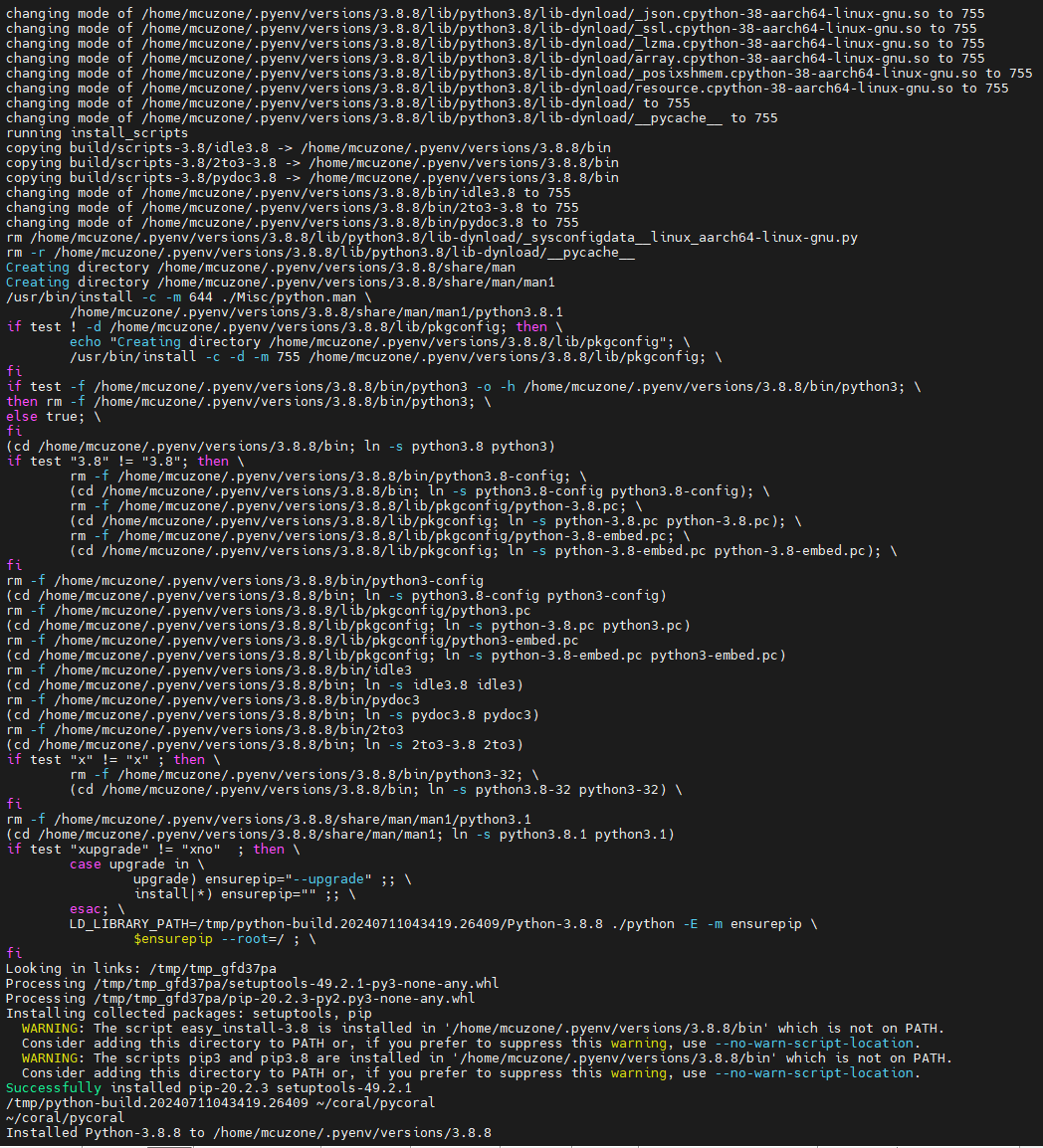

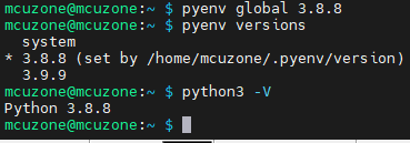

接下来我们可以利用pyenv安装老系统版本Python
pyenv install -v 3.8.8
等待安装成功后我们将系统Python版本更改为3.8.8
pyenv global 3.8.8
更改成功后可以查看当前Python使用版本为3.8.8

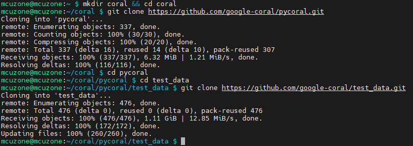

环境配置完成后我们接下来下载演示代码
依次输入以下命令进行下载
mkdir coral && cd coral
git clone https://github.com/google-coral/pycoral.git
cd pycoral
cd test_data
git clone https://github.com/google-coral/test_data.git

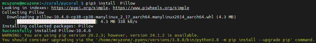

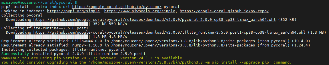

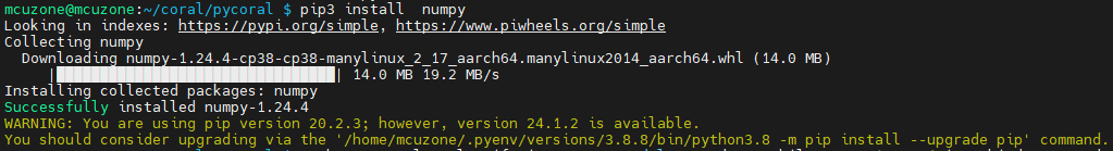

接下来下载代码运行模组
pip3 install  numpy
pip3 install  Pillow
pip3 install --extra-index-url https://google-coral.github.io/py-repo/ pycoral
模组下载完成后返回 coral/pycoral路径下

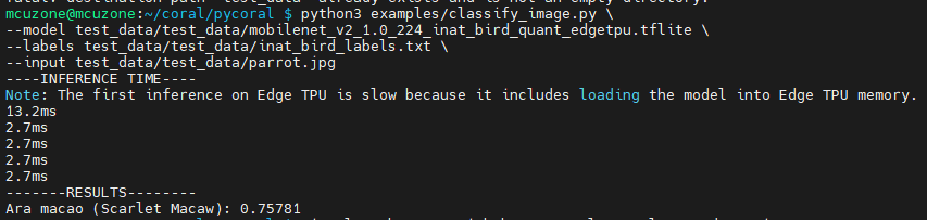

输入以下代码进行代码运行
python3 examples/classify_image.py \
--model test_data/test_data/mobilenet_v2_1.0_224_inat_bird_quant_edgetpu.tflite \
--labels test_data/test_data/inat_bird_labels.txt \
--input test_data/test_data/parrot.jpg

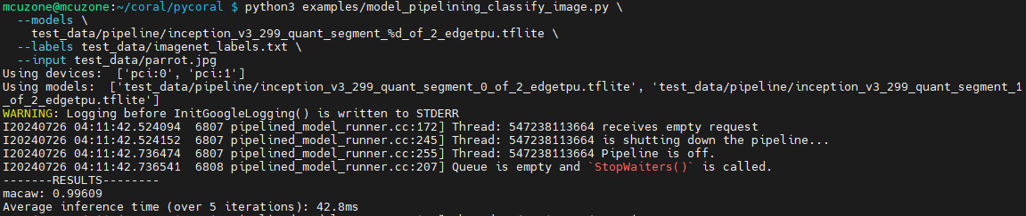

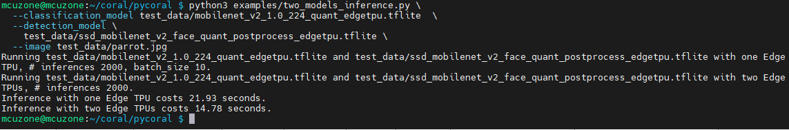

上面示例代码为单TPU操作代码使用
下面演示双TPU跑多个模型:
双TPU跑一个模型:
